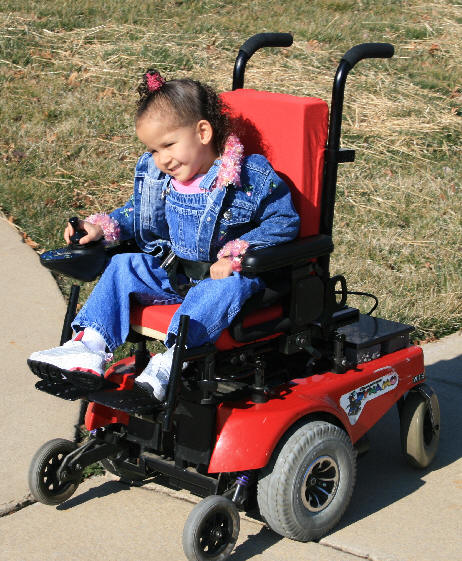

Here
is yet another example of a kids paediatric powerchair that is seating this poor girl about 9
inches too high and massively too wide with all the manoeuvrability and access
as well as reach problems that this causes her. How can she park close to a
kitchen worktop to reach something?
Special seating is no excuse for
this! She does not need huge batteries (the reason the powerchair is built
so big to accommodate them) as she weighs almost nothing compared to what this over engineered
solution can take.

Here's
another extreme example sent to me by a reader. 25.5 inch wide Powerchair with a 14 inch wide slim
female user! And they actually show it in a brochure! My chair is 25.25 inches wide
too, but that's great! No point making it narrower because so am I...
Look at the picture. The casters are "wide" apart so they hit everything. And
small to try and prevent that happening. Making the chair hopeless outside in
the real world.
A much smaller chair with bigger casters would allow better outdoor and indoor
capability.
